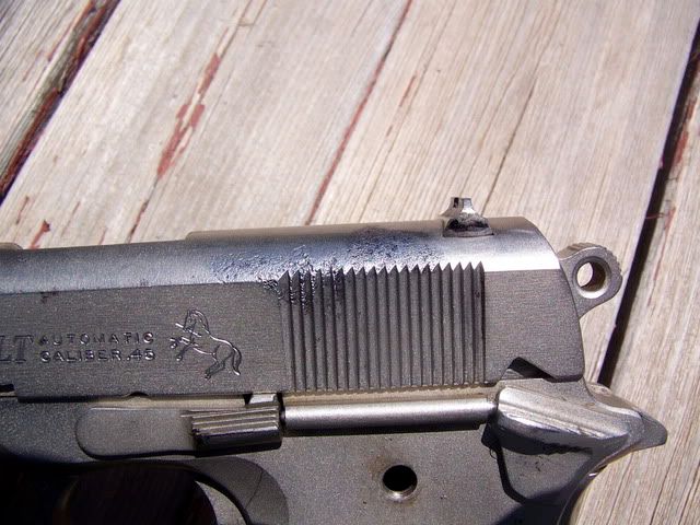

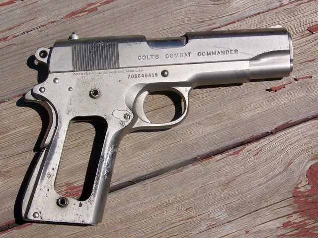

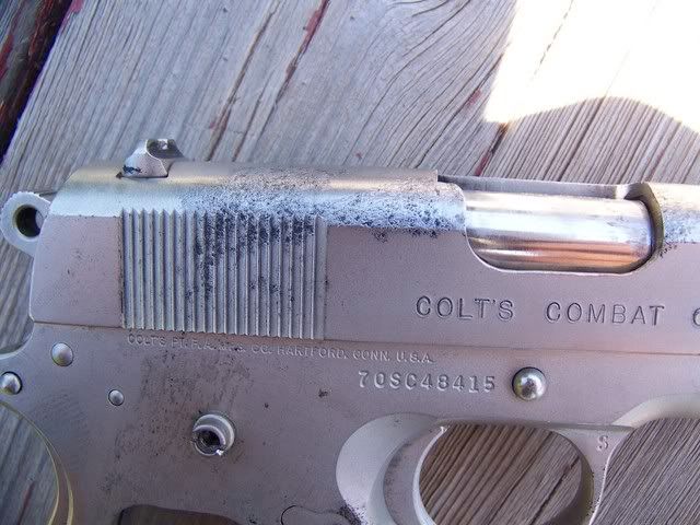

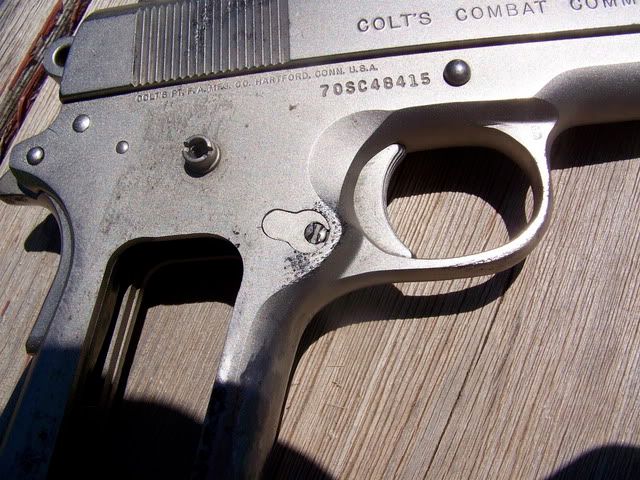

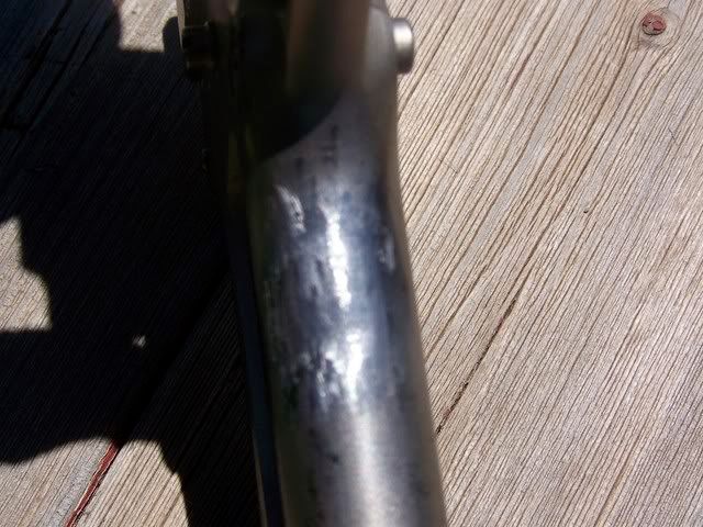

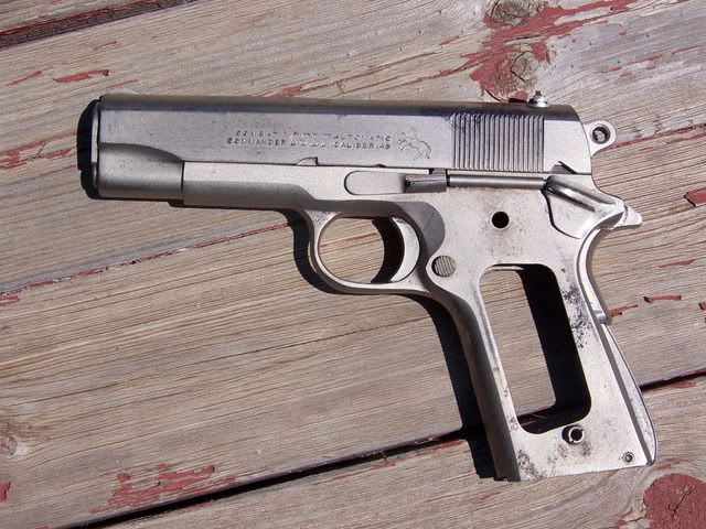

I hesitate to post this with Bob, Dwayne, and Mr. Rogers all having pistols posted on the front page, but I figured why not.
A little bit of history on the gun. This is one that my Dad bought off of gunbroker for cheap. Obviously the condition was pretty poor; however, he thought it would make a beater gun that he wouldn't have to worry about. When I got the gun it was actually quite unsafe as it was firing in full auto. While that is pretty cool, its not exactly desirable. It turns out that an incorrectly fit grip safety can cause this malady. I then received the gun and began the journey or reworking the gun and attempting to remove all of the pits while maintaining the natural lines of the gun. Most of the parts on the gun were replaced with various after market components. I have included a couple before pictures and a couple pictures of the gun's current progress. The gun is awaiting a road trip "back east" where all of the machine work will be completed on the gun. Including a flat top and sight cuts. Once all of the work is completed the gun will be cerakoted in Graphite black. I hope you enjoy the pics.
