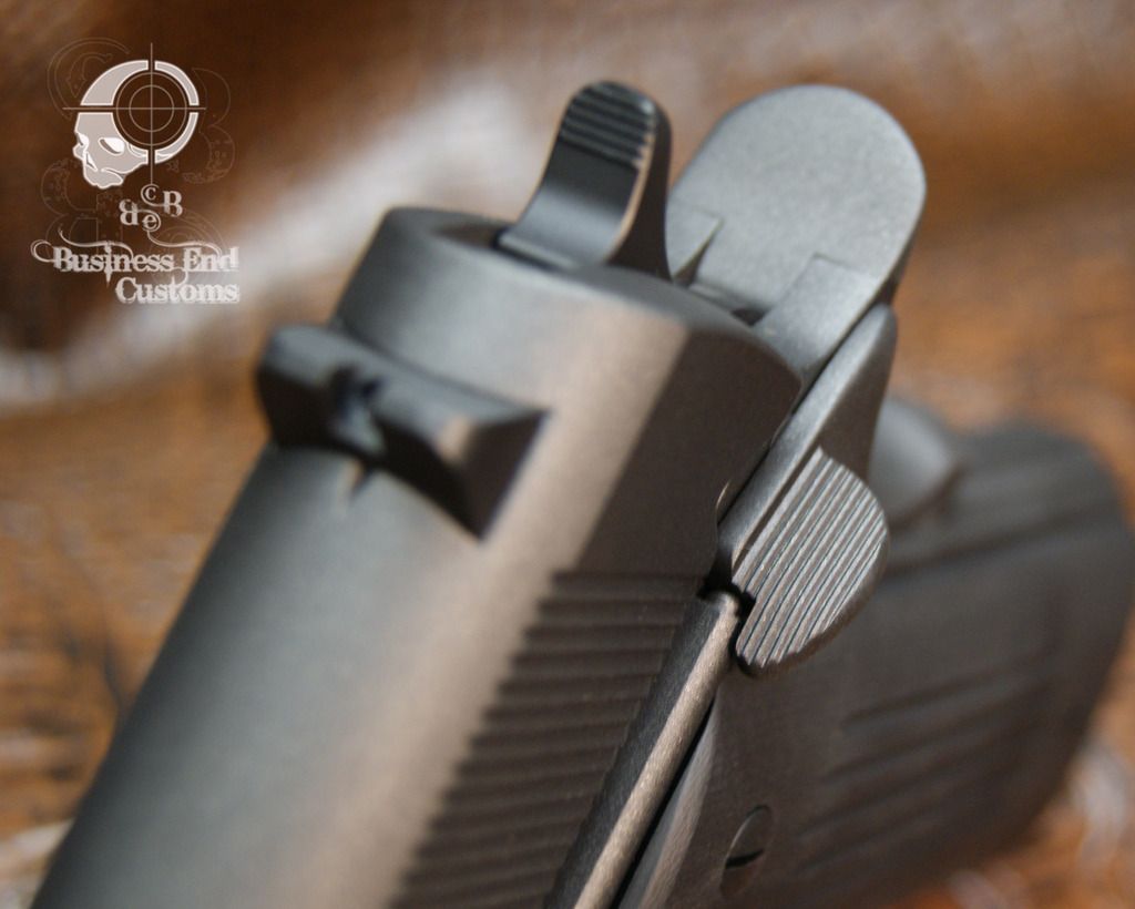

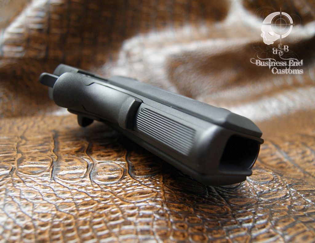

This project started out a a standard older NM Mil-Spec and receive a little bit of work.
Rogers Precision Diamond serrations
New Harrison Retro hammer, sear and disconnector
Action job tunes to 3.5lbs
New Harrison Retro rear sight
Mill front dovetail, fabricated & install front sight with gold bead
New Kart barrel fitted
Re-contoured EGW monogrammed bushing set with serrations
Fit, Modified & contoured Wilson Combat concealment grip safety
Modified & re-contoured EGW thumb safety
Modified EGW slide stop
Fit new Wilson combat extractor w/spare
Installed Chen mainspring housing w/ matching Rogers serrations & round butt
Bevel & blend magwell
Fit new Oversized EGW ejector
Roll marks removed from the slide
Carry bevel
Flush & crown barrel
Lower & forward cut ejection port
Wilson combat medium trigger
New serrated Derwood MFG G10 grips (coated)
New Wilson Combat pins, hammer strut , plunger tube, guide rod , grip screws
New EGW oversized firing pin stop
Coated in a mix of Tungsten & Graphite black w/ black accents over Manganese Phosphate.

Amazing work Lou, really like the recoil spring plug.
I am interested in some pics of the front sight, saw the pic after you finished blending, how did the finished product turn out?

I dig every single feature of this gun! Amazing work and detail execution!! Now, let me shoot it and fondle it please. ;)
12,005 Posts
Simple and elegant, with a touch of attitude. One of the most appealing builds I've seen this year. Incredibly well done! :rock:
300 Posts
Wow that is a beautiful piece of work!
3,164 Posts
Like someone else said, that is exactly how (I think) a 1911 should look. It's bad-ass. It looks clean, functional, and devoid of bells and whistles, yet if an admirer knows anything about 1911s, he'll realize that it is full of subtle custom touches that enhance an already timeless design. That gun looks like a true fighting pistol! I'm going to have one built just like it...
