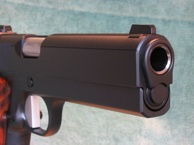

This Baer Monolith belongs to a forum member and friend. The last item on his wish list was "Go through and clean up the whole dang thing." Hmmmmm, sounds like carte blanche to me...Oh boy!
The sights are Tier One, custom fabricated by our own Chuck Rogers, specifically altered to correct an alignment problem.

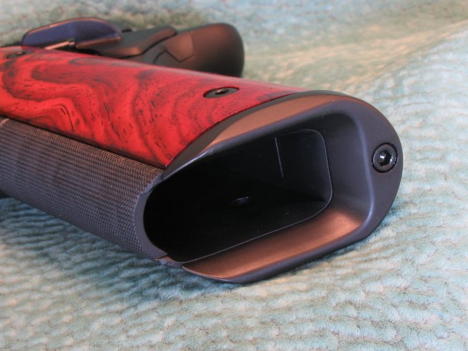

The grip safety is the original Baer. After high-cutting the trigger guard, I heavily recontoured the grip safety to allow the rear of the gun to drop further into the hand. I also installed a stop pin for the right side ambi-safety paddle.

Chuck...what was the diagnosis with the alignment and how did you solve it with custom sights?
7,062 Posts
DD,
Bob did not fit this barrel.
This one came from the manufacturer with a small windage mis-alignment.
The sights were adjusted but looked odd being off center.
I fabricated the front and rear Tier One sights with offsets to compensate. The result is perfectly centered sights that shoot point of aim.

Bob and chuck....is a trigger guard undercut useless without a beavertail, or is it still a good mod no matter?
That undercut is superb, I can only imagine how nice it feels with a perfectly blended and increased cut BT.
That is cool, Chuck! One thing I hate is crooked sights.
A high grip beavertail is an important part of the process in order to get the full benefit. It's easy to feel the difference. I alter the trigger guard first, and if you reassemble and grip the gun at that point, you can tell something is missing. As soon as the GS is lifted, the pistol settles and levels into the hand and feels just right. :)
