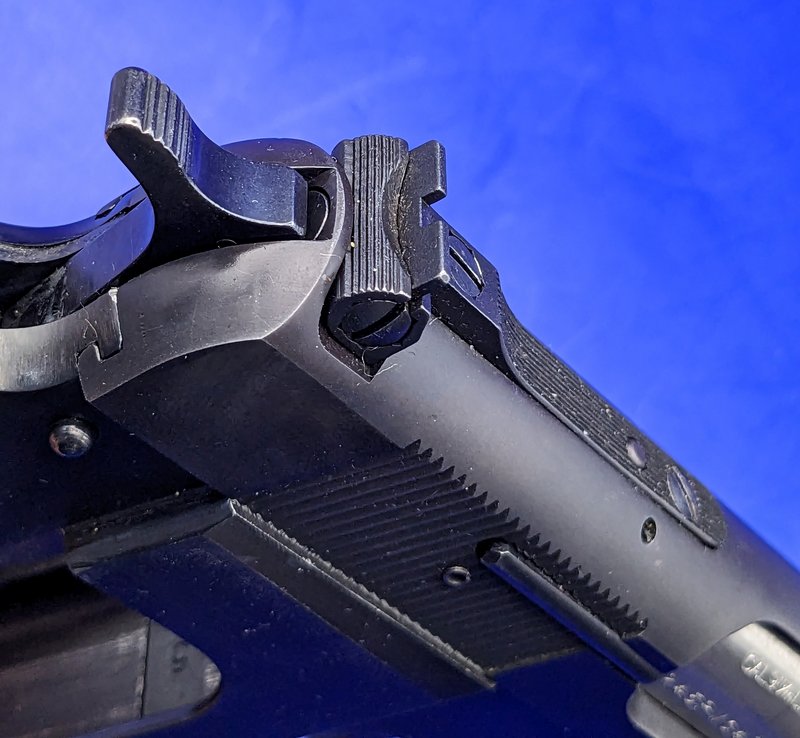

Post a pic of the rear sight install. There might be some tells there.
Here are a couple of details on the rear sight. The install has the rear of the sight fully inset into the slide rather than an open back (such as many (not all) Behlert S&W sights). The few Hoag Hi Powers I have seen have the sight fully inset into the slide, like my example. There is a slight curve or radius at the rear of the cut, which is similar to some of the Hoag installs I have seen. The rear of the cut is also very close to the back edge of the slide, which is also consistent with some Hoag sight installs. But, others could be doing the same, and as longarm mentions, the sights could have been installed someone trained or who worked for Hoag.

Thanks Rellascout. Your detailed images of Hoag rear sight installation are excellent. I agree, very similar. That said, probably best I can do is say in the style of or manner of Hoag, and that would only be for the sights, not a custom build with his additional recognized enhancements.
Great pictures, they show it’s not the original rear sight dovetail like I’ve seen on some other HP’s. Wow really impressive! Thanks for sharing.
