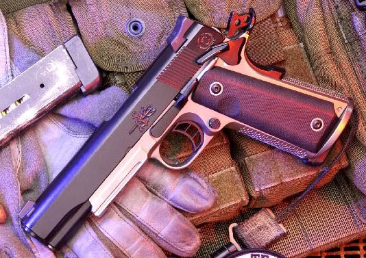

Shootcraps,
Can you repost your picture? All I can see is a little slit at the top of the picture, and what I can see is intriguing. Thanks.
Rather than have him repost the picture, which displays fine for me, why don't you try clicking here. I suspect what ever your problem with viewing the image is, it won't be helped by him reposting it.
Thanks Tim. sgist, I emailed you a link for the picture.
NP3 seems to hold up just fine. Does not appear yellow.
