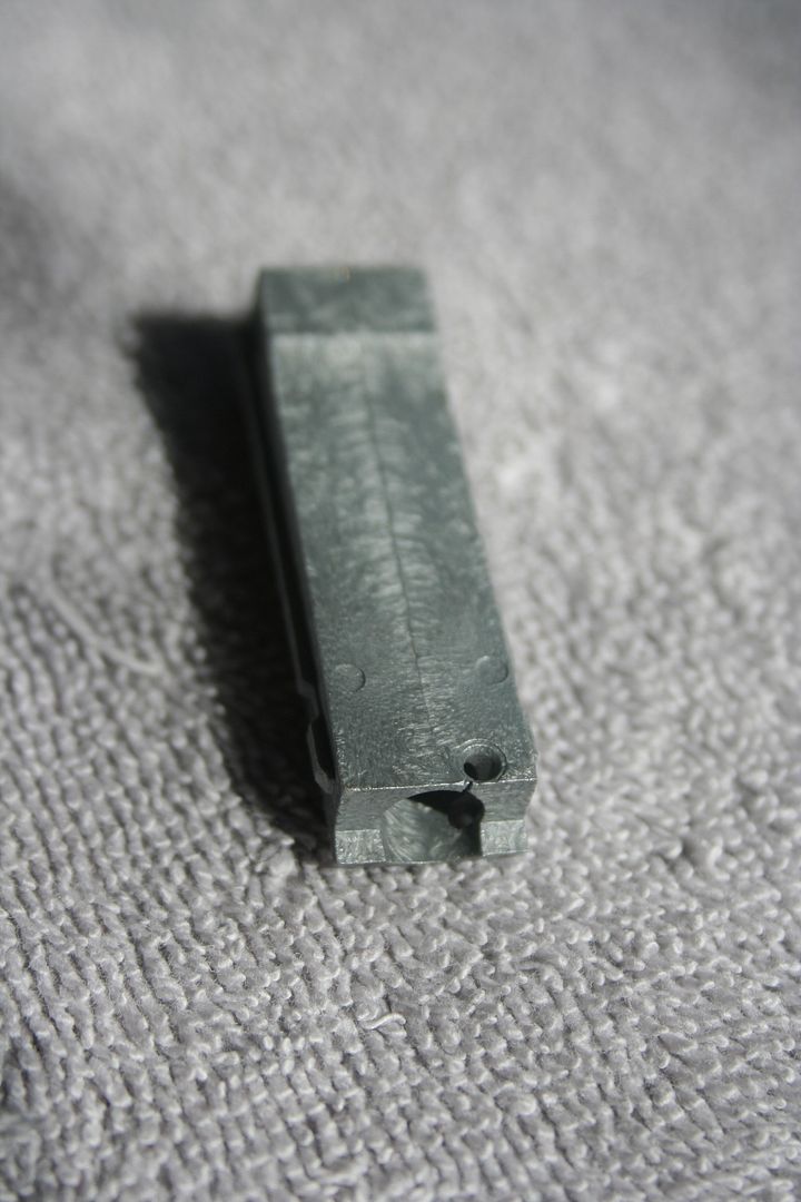

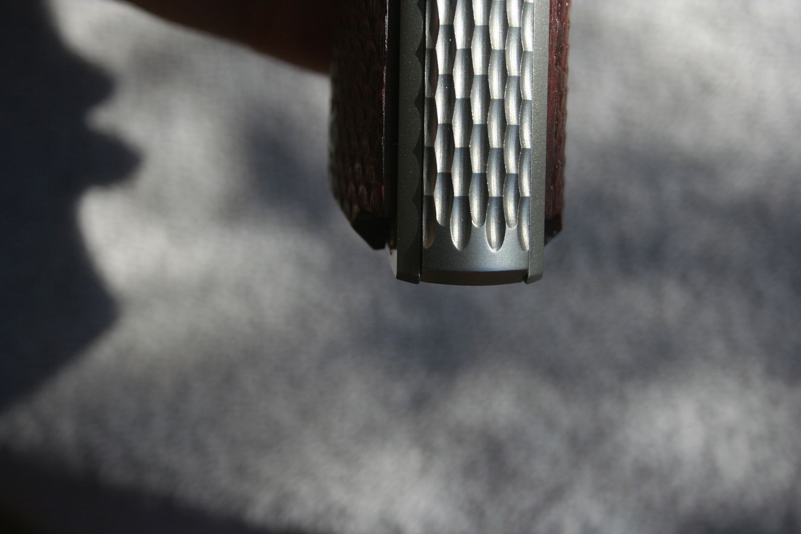

I generally do not in Colts. I think the oldest Colt I have with one of the Nylon composit housings is a 1988 GCNM in SS. I did replace one in a 1991 SS Commander I got several years ago that had an interesting history. It had been in the bed toolbox of a pickup truck for years covered in dirty oil, diesel and other crud. It was in a flap holster that I tossed. My friend was going to throw it out as it had a horrible trigger pull he said. I offered him $300 for it and he was thrilled. During a detail strip/clean/put together again I replaced the sear and disconnector and put in new Series 80 parts from Cylinder and slide. I also fit a longer Wilson trigger and put on wood stocks I bought off the Colt website back when they sold stuff there. I could not get the "plastic" MSH as clean as I liked and could not find a new one for sale in Silver at the time so I put on a SS one from EGW that looked pretty much like the original. Not shown in the photo is I replaced all of the springs in the pistol. In addition to the recoil, main, and firing pin spring, I also replaced the plunger and mag release spring and the tiny spring in the Series 80 plunger. The EGW MSH dropped right in. What took the most work is fitting the Wilson trigger.
Now a little off topic but I did have a crack on the inside of the plastic MSH on my 2005 Kimber Grand Raptor. Now several folks point out that area is not stressed when the MSH is in the pistol, but if the crack gets worse the main or hammer spring and associated parts could come out and say hello to you when you do not want them to during a field strip.

I ordered a Wilson MSH in SS which was a very Close match to the original Kimpie plastic one for about the same money as a new plastic one would be from Kimpie. Now this one took me some time to get it to fit the pistol. As it came the grip safety did not operate and given Kimber IIs have the Swartz like mechanical firing pin safety which runs off the grip safety this is a even bigger deal than it would normally be. Anyway a little work and the pistol looks like it did except now it has a SS MSH.
Back to Colt I was sort of interested so I weighed the empty MSHs. The Kimber was close to 6 grams and the Colt was 7 grams. A new plastic STI flat MSH I had in my parts box was also 7 grams.
