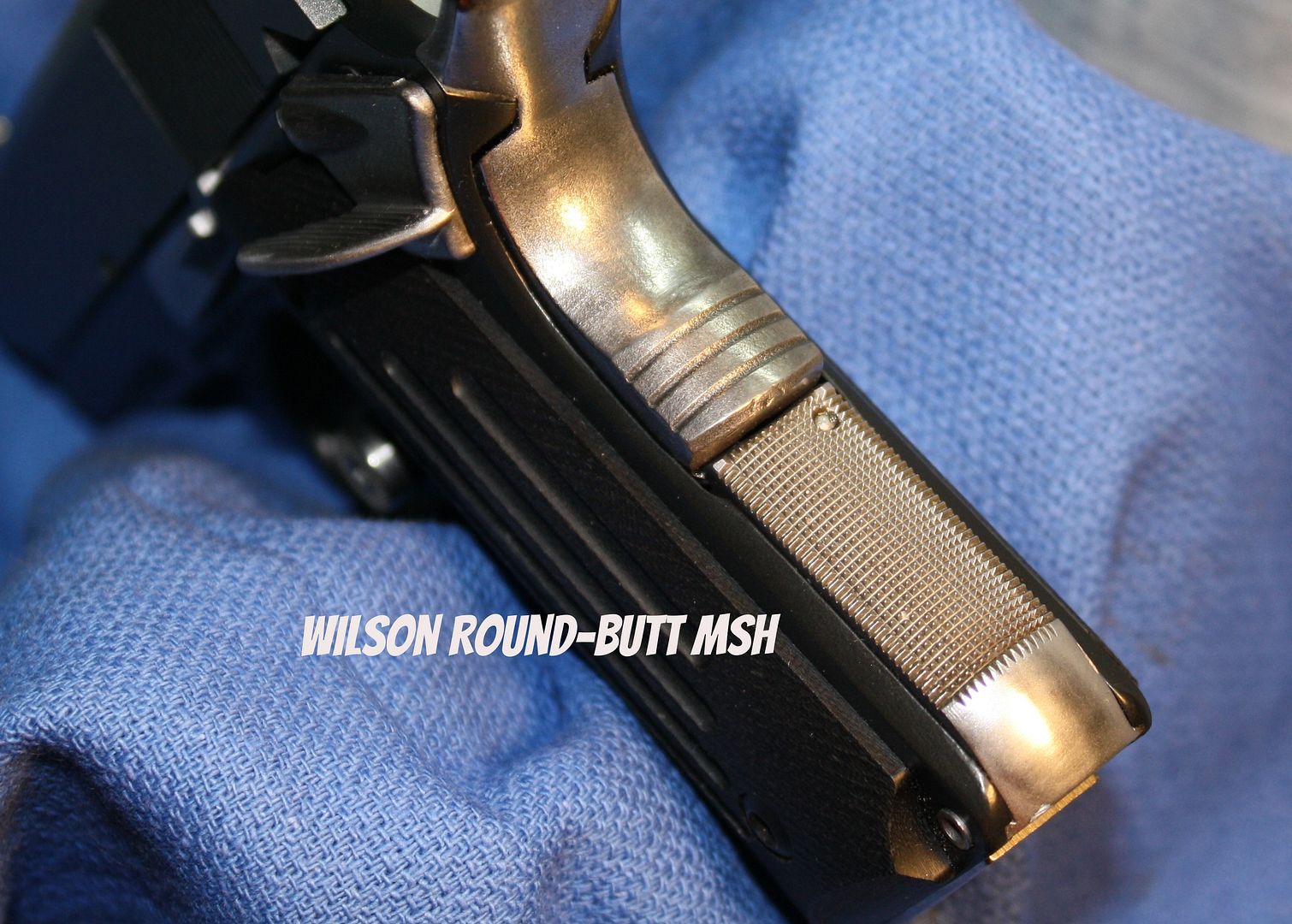

bamashooter- I used the Wilson Combat Round-Butt MSH. It took a little modification of the pointy ends of the grip frame to match the contour and some filing on the bottom of the Rock grip safety to get things to function properly. I used the main spring that came with the Rock MSH and the stock plunger and bottom cup as the Ed Brown parts I had were too long. I can't speak to the difference in spring diameters because I didn't try any of the Wolff main springs I had on hand as they were obviously for a full-sized MSH and were too long. No complaints though, it slams the EGW hammer I put on the thing just fine for now.
This is the Wilson MSH:
