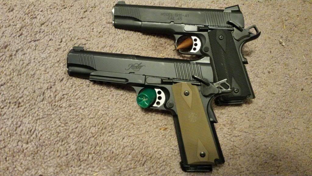

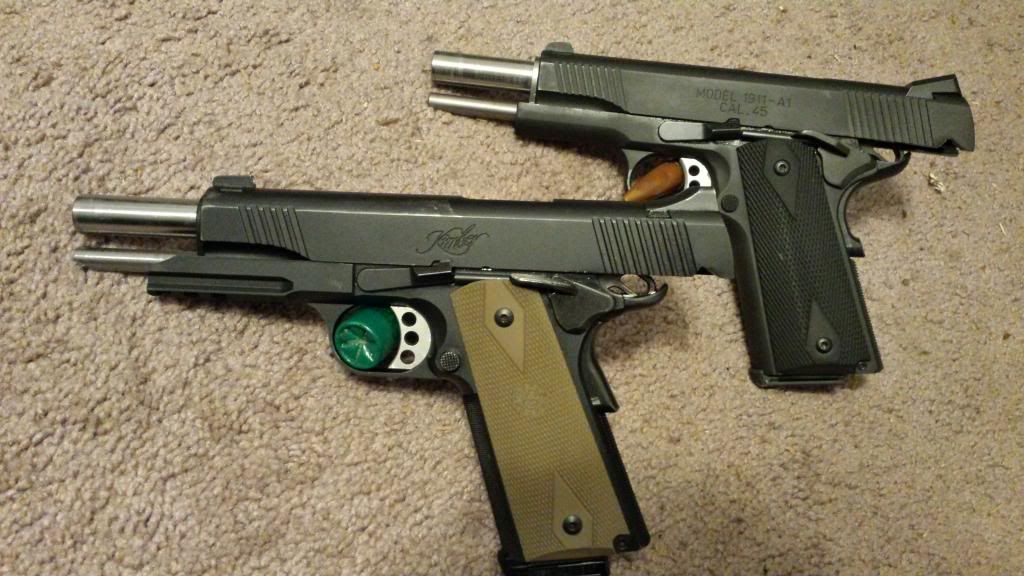

replaced with a Wilson 1pc... drop in fit... feels a litter more nosy heavy yet balanced. Recoil feels more "centered" in hand. If if that makes any since... pictures compare length of Kimber 1pc to Wilson Combat
