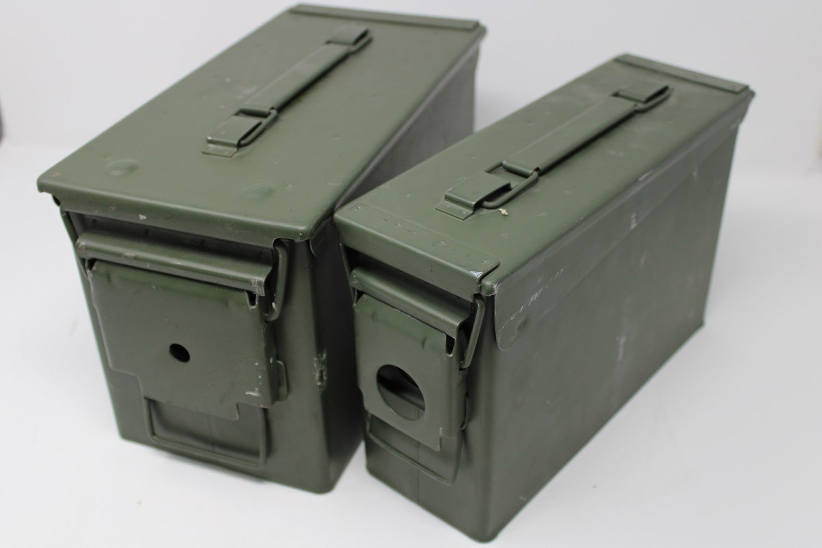

The steel M2 Ammunition Can was introduced to U.S military branches on the 21st of September, 1942. The M2 ammo can was designed to hold linked belts of .50 cal. ammo for the M2 Browning machinegun, but its large capacity and carry handle made it effective for storing other munitions and supplies. It was, however, found inadequate in cold- and wet-weather environments. So, in the 1950s, the M2 was replaced with the now-infamous M2A1, complete with weatherproof seals and a redesigned latch and lid made to handle more weight and stack easily. Some say the M2A1 ammo can ( a proper military surplus can, that is) represents perfection in small arms munition storage. It’s a perfectly round wheel that can’t be reinvented. Today, we’re breaking down why this old relic remains one of the best ammo cans you can buy and use today.
The M2A1 Can at a Glance
First off, the M2A1 is not your typical pretty, shiny ammo box. If you make the right move and buy a coupla’ these cans to store your munitions, they’ll might arrive with a bit of chipped paint, faded lettering, and plenty of dust. They’re coated with a very tough OD green paint that’s functional, but certainly not a looker. They’re almost always authentic Army surplus, meaning they’ve already handled hundreds of rounds of ammo, sat outside at a qualification range, or been kept in a Conex shipping container at 110 degrees. That’s not to say these steel cans aren’t capable of surviving all those conditions and a hundred years of the same, or more. They have, they do, and they will.
Main Specs / Features
  • Pressed solid steel sides, lid, and bottom.
  • Seam-welded to make one unibody box.
  • Latch, hinge, handle also welded to body.
  • End-opening lid with quick release hinge.
  • Quick release latch with tight snap for handling high amounts of weight.
  • Rubber gasket under lid makes can waterproof when latched is closed.
  • Handle attached to lid by rectangular wire loops. Folds flat for stacking.
  • Lid skirts protect contents when lid is partially opened.
  • Cans are capable of holding at least 50 pounds each.

The M2A1 can is available in more than one size. The smaller variant (officially titled the M19A1) is typically used by the forces to store and carry the 5.56 and 7.62 NATO ammunition for small arms. These smaller cans are often simply called “.30-cal cans.” Each small can is capable of holding 200 cartridges of 7.62 NATO, and about 540 rounds of 5.56 NATO, commonly held in stripped clips for hand loading.
Importantly, both the M2A1 and M19A1 sport the same steel, latches and lids, seals, and painted finishes.
