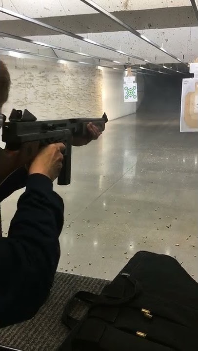

I have a CMMG "AR" carbine in .45acp with a Leupold DeltaPoint Pro on it. It’s not blowback, it locks up similar to an AR but with CMMG's hybrid design. So it has no heavy bolt slamming back and forth. The bolt carrier group looks very similar to a standard AR. It looks like a beast with the big barrel, but shoots very easy. It’s fun to shoot on the pistol steel plate range, and whacks the thick steel with noticeably more authority than the 1911 in the same caliber. I wanted something different since everyone seems to have 9mm PCCs. I would never purchase another CMMG however, as their customer service is horrible.

#31 · (Edited)
Mark60, you’re the first shooter that I’ve come across in all the forums that I’m on that has ever mentioned the CNC lower I do believe. For years I thought that I was the only guy Justin was building them for, I have 3. How long have you had yours? I’ve shot mine in several zombie and ipsc matches. If primers were available I’d shoot them much more. A very fun gun. This was my first sbr’ed .45 build, it has a forward charger on the left side. Never liked the AR charging handle. Bad elbows.
