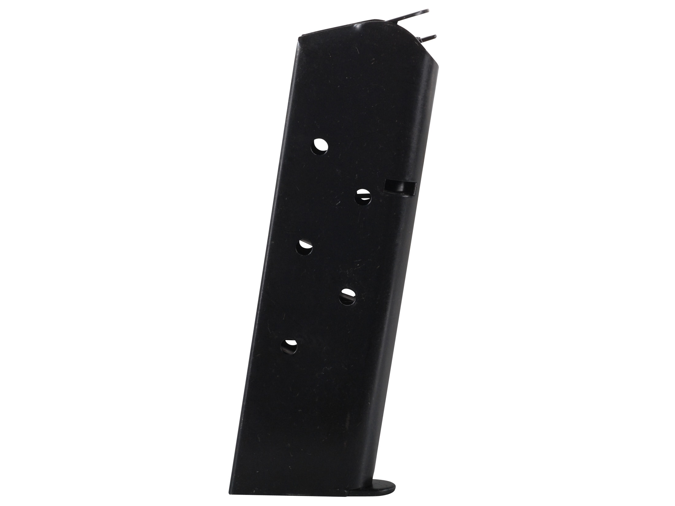

I prefer 7 rounders, but I also prefer bumper pads on my mags. They are more comfortable in the hand, more comfortable on the belt, and I don't pinch my palm when inserting them in the gun.
The 1911 is a pretty big gun. The extra 3/4" of an inch (or less with a low profile pad) added by the bumper pad is insignificant for me as far as conceal-ability goes.
If a flush mag is what you like, and want, they are available.
The history is - Browning invented the 7 round mag with what became known as GI feed lips. It works great with 230gr ball ammo.
When semi-wadcutters became a common bullet shape, and then hollow points, that are both typically shorter than 230gr ball, they found these rounds didn't feed as well from GI feed lipped mags.
Colt developed the hybrid feed lips and others developed wadcutter feed lips that work better with these shorter rounds.
Currently, I believe CheckMate may be the only maker producing anything other than wadcutter feed lipped mags. Wilson, McCormick, Tripp, etc, all make mags with wadcutter feed lips.
Not to state the obvious, but I've had good luck with these...
The downside to ordering a "Colt" mag is that Colt doesn't make mags, they contract them out. When you order a Colt mag you don't really know what you're getting until it arrives.
For instance, if you look at the two pictures in the MidwayUSA ad, one has a GI follower and the other has the CheckMate Patented Follower (CMF). The description also doesn't identify the type of feed lips used. If you want a particular mag, with particular features, ordering a "Colt" mag could be a problem, because you may not get what you want. However, if it only matters that it is a 7 rounder, it's not much of an issue.
Besides Metalform magazines, I have also recently ordered and received a few Kimber factory magazines. In appearance they are identical to the one that came with my Series 1 gun except that the original magazine isn't marked on the bottom of the magazine and the new ones are. They seem to feed dummy rounds fine, but I have not tried them out in live fire yet.
FWIW, Metalform seems to make magazines with quite a few different follower designs. They do come in both blued and stainless though all my recent purchases have been stainless. They all seem to work, but I like the round followers the best.
