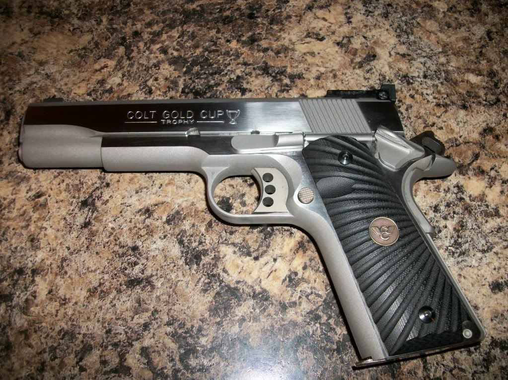

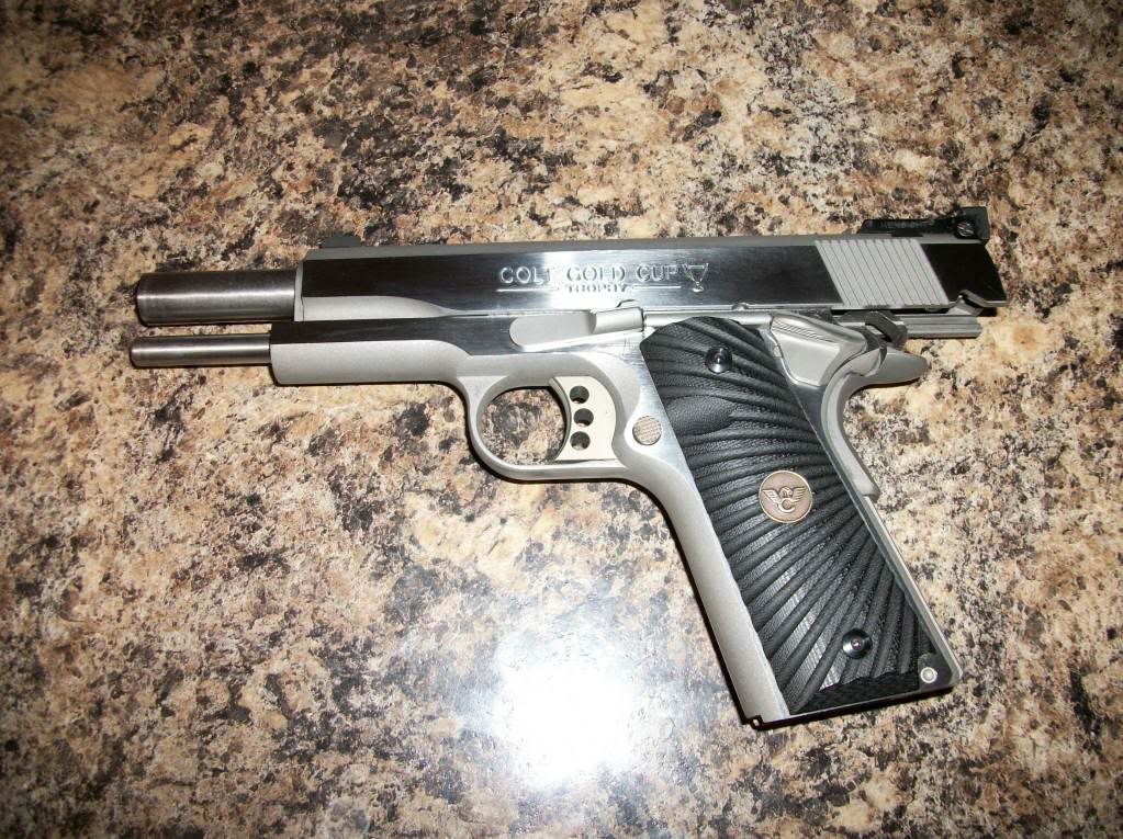

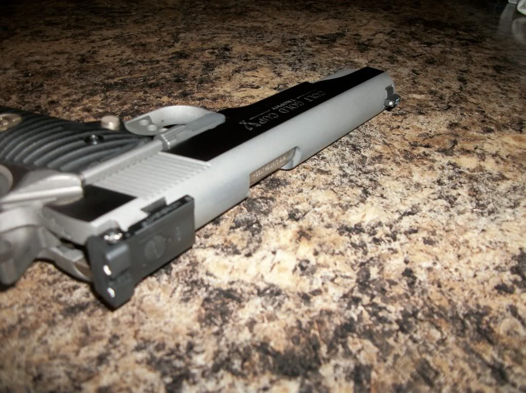

Well I did some upgrades to the Gold Cup, I added a set of Wilson combat grips, full length guide rod with shok-buf and a set of fully adjustable Trijicon night sights.
The front is a .180 Trijicon, and the rear is a fully adjustable Kensight. My gunsmith locally installed them for me. He only charged me 25.00 for the install. The front sight was 65 and the rear was 116 so I was out the door for 215 bucks.
I believe it was a direct fit. I know it only took him about an hour to do the install and that included laser bore sighting to get it in the ballpark for me.
So much better than the original all black sights...:rock:
nice job JP...looks nice. The GC is a great gun!

We're not upset, Nighthawk. Us old guys just smile and say "look at the Nimrod"......
Seriously - a part that makes the gun heavier, makes field stripping more difficult, prevents you from operating the gun one handed in a combat situation - everyone should have one, of course! As Clint Eastwood would say, "It's Stylish."
FLGRs have been tested and proven to have no effect on accuracy, and the spring is already supported by the recoil spring plug from one end and the recoil spring guide on the other so perhaps 3/8" is not fully "supported" by the stock setup. It's original purpose was simply as a gun weight - made of tunsten, it did help keep the muzzle down in early IPSC games - if you didn't have to carry it all day.
