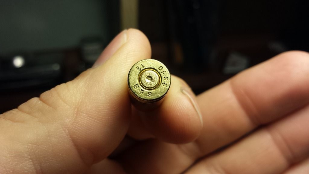

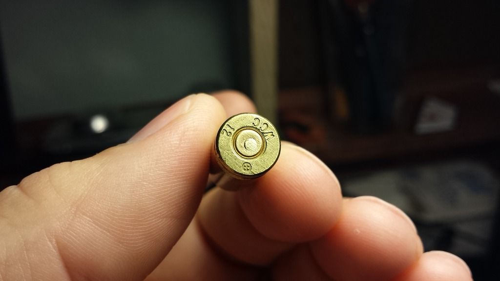

I have a MKIII that just developed an issue with what I thought was light hammer strikes.
I recently began reloading using Sellier & Bellot primers. I thought maybe the primers were a little harder than what I had been shooting with factory ammo, so I removed the reduced power hammer spring that the MKIII had and put back in a new factory full power hammer spring thinking this would solve it.
Went out to the range yesterday and had the same issue. About one out of ten wouldn't ignite the primer. I also was shooting a well used MKII with fresh factory springs that had no issues with the same ammo (the MKII does not have the sear lever that blocks the firing pin).
This time a took a closer look at the primers of the fired rounds to compare the strikes from each pistol. I've include a picture of each. What has me a little baffled is the strike from the MKIII. It appears the firing pin never contacted the primer. The center area that is deformed is convex, not concave like a firing pin strike makes when hitting a primer. It appears to me that what is contacting the primer when the hammer falls is the slide (not sure what the area on the slide hold the round in the chamber is called). I think that round raised area on the spent primer is the result of pressing against the face of the slide with an empty hole where the firing pin should be coming through. This is happening to every round going through the MKIII, not just randomly.
I disassembled and clean and inspected everything and it looks good. My thought is that for some reason the sear is blocking the firing pin. I function checked the sear block on an empty chamber by cocking the hammer and slowly pulling the trigger at the same time pressing on the firing pin with a punch....I could feel the sear block releasing the firing pin before the trigger was pulled far enough to release the hammer.
The thought that the primer is igniting without a firing pin strike goes against the reason for the sear lever block doesn't it?
The first picture is of the MKIII strike or non strike. The second one is from the MKII. The third is the type of sear lever in this MKIII that is designed to block the firing pin until the trigger is depressed.
Any ideas?
The first case is showing signs of excessive pressure. What is happening is the primer is expanding into the firing pin hole and leaving that resulting flattened look. A little bit of shaving from the primer is probably clogging your firing pin channel and causing the misfires.
A few things to look at.
1) Stop using that ammo. It may be high pressure for your gun.
2) Have a gunsmith inspect your firing pin hole. You may have an oversize firing pin hole or a barrel chamber throat that is too tight and causing excess pressure. In my experience a chamber reaming by a competent pistolsmith will solve this pressure issue.

The first pic suggests excessive pressure, whilst the second case has a primer that looks like a lot of factory ammo... the 9x19 is a high pressure pistol cartridge to start out with...

Thanks for the suggestions.
I think that Wilson Rep may have been right when he said that there may be a bit primer brass in the firing pin hole. The whole thing might have begun with the lighter hammer spring, depending on how light it was and the weight or wear of the recoil spring in combination. If the gun was unlocking prematurely with the lighter hammer spring and the firing pin hole got a bit of brass from the primer, it could have possibly bound up the firing pin and initially replacing the hammer spring with the original might not have been able to overcome this. I would check to make sure the FP hole is clear, keep the original hammer spring, and also check your reloads as suggested.
I finally got a chance to shoot some more rounds to try and figure out what is going on with these reloads. First a shot 5 tula steel cased and then five American eagle brass all factory loads. They all appear to me as good looking strikes to the primer. Then I shot three reloads that I loaded with just 3.6 grains of titegroup which is at the bottom of the range.
This is the load:
124 gr berrys plated RN
1.51 c.o.l.
3.6 grains titegroup
Sellier and Bellot small pistol primer
The only thing different from this load and the load that was causing the results in the original pictures in this post is I reduced the powder by about .2 grains.
You can see that for each of the reloads the primer has been breached. On the primer in the top right I dug out the residue with a needle just to see what it looked like.
I haven't tried any reloads that have CCI primers. Not sure that would even make a difference.
