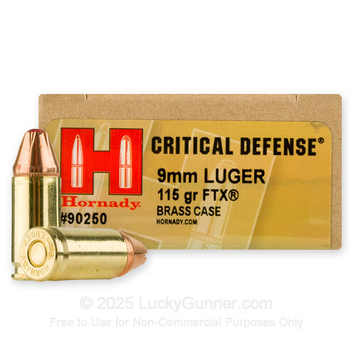

Here is their gelatin test (4 layers of denim) for the Hornady 115 gr Critical Defense out of a 3.5" barrel.
Not too shabby at all. I carry the Hornady Critical Duty 135 gr round myself, and here is the test for that one, again in the S&W M&P9C.
They don't have the video for this one, testing the +P, which I think is unecessary, but the regular round penetrates 19.0", expands to an average of 0.43 inches.
The 115 Critical Defense round penetrates less, but it's a bit faster so expansion is greater. I think you're in good shape, and being NJ legal is just icing on the cake!
The 115 gr Critical Defense round above, again, 3.5" barrel. Penetration 13.1", expansion 0.50", vel 1143.
