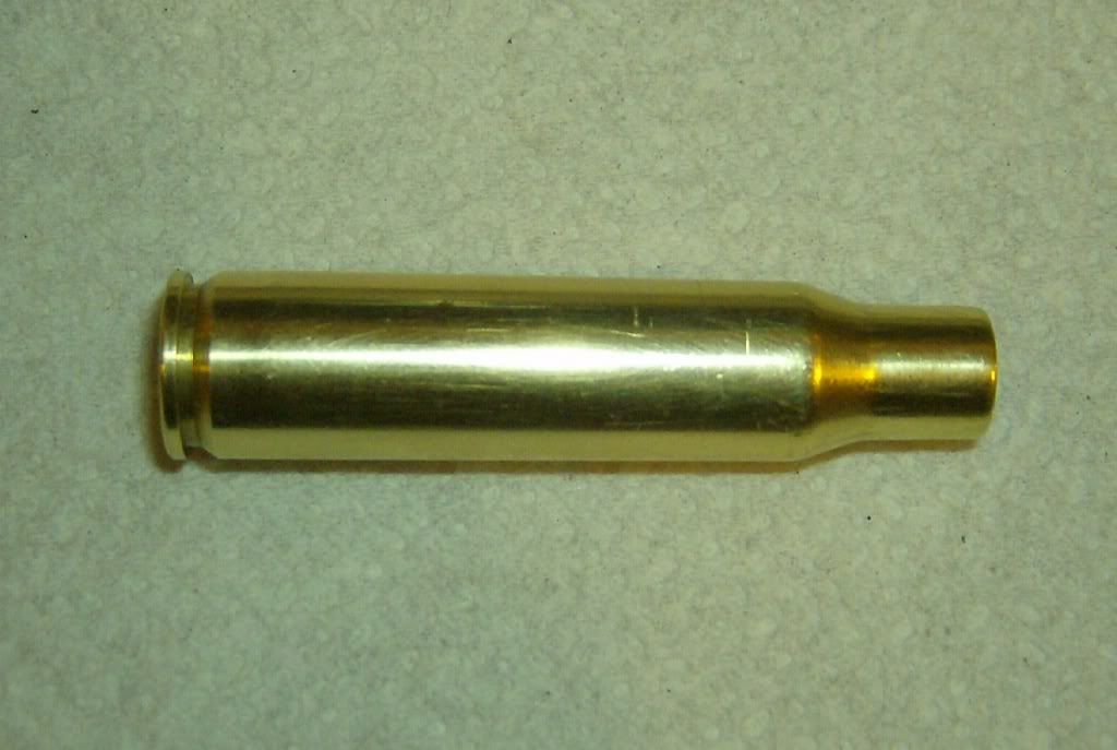

I got playing when I came home from work today. I have hundreds of 30-06 once fired brass in a bucket but nothing to shoot them in. So I started cutting one and sizing it down with the .308 dies. When I final got it to where I wanted it (took 8 steps), I annealed the mouth of the case and then shinned it up with some steel wool. This is what I ended up with:
I tried the empty brass in my .308, It seems to fit well and ejects good (A-bolt)
I plan on fire-forming it (once I figure a safe load to do that with - no bullet), then running it through the full length sizer again. Then load it up and see what happens :).
I will have to start light though as a factory Federal .308 brass weighs 150.2 grains and this brass weighs 182.9 grains. Quite a smaller case volume I assume. Has anyone else here ever tried this?

Good point. My "cheap" calibers show it to be the same (or very close), but I will mike it at the shop tomorrow with some more reliable equipment. If I have to adjust the wall thickness would turning the outside be ok? or should I ream the inside.
Thank you for the advise - I tend to get ahead of myself sometimes. :)
You'll probably get as many responses on outside turning vs inside reaming (kind of like full length vs GI guide rod or shok-buff vs no shok-buff :biglaugh: ) but unless you are shooting benchrest competition, outside should be fine. Just watch it as you get close to the neck-shoulder junction.

Before you get all ready to turn or ream the necks, measure them carefully.
Once fired brass is already stretching and thinning. Depending upon caliber change and parent cartridge and number of firings, many of my formed cases are already within spec, so I don't turn or ream at all. You might not be so lucky, but you don't know until you measure carefully.

I have some 150 grain bullets that I might try in the fire-forming. This part is new to me. My original plan was to use cornmeal on top of longshot - with a small wad. The other thought that crossed my mind for forming was to use some (don't laugh please :)) black powder. I have been a blackpowder shooter for years - it is something that I am very confident in. My theory was that it could not over pressure anything, and the sudden violent explosion of a charge with no bullet (compared to smokeless with no bullet) would form the brass.
But it would be messy :). I have 10+ pounds of blackpowder on hand now (mill my own), other than that I have Bullseye, Longshot, Red dot, and Reloader 15. Any suggestions on these would be appreciated.

I would stand down on the black powder
You don’t want this anywhere near your smokeless powder gun, components or loading gear.
Besides, the black powder has poor energy potential
You need to develop enough energy so the case “forms” in the chamber
From the powders you mentioned, RL-15 would be my choice
A minimum or starting charge of say 30 – 35 grains of the RL-15 with the 150 grainers seated against the lands will generate enough pressure spike to “form” the brass
With the bullet seated against the lands this will keep the case from “flowing”
Something you don’t want and make it “form” to the chamber instead, this is desired

Even while fire forming, you get reasonably accuracy. I don't use a wad/filler method. I load those die formed cases with bullets and several powder selections and start developing loads right away. You won't be able to fine tune a load, but you'll eliminate the bad loads.
Just exactly like Gerk says, jamb the bullets lightly against the lands. It helps pressure develop more fully so the brass forms outward into the shoulder of the chamber.
Oh, and by the way. Don't forget to clean your chamber real good before you fire form. Don't ask me and my extractor how we know.

I plan on loading a few with the Reloader 15 and 150 grain Winchester bullets over the next few nights.
I will follow the advise of you and Geek and seat the bullets so that they just touch the lands.
I will shoot them on Saturday and post some pictures of the fully formed brass.
