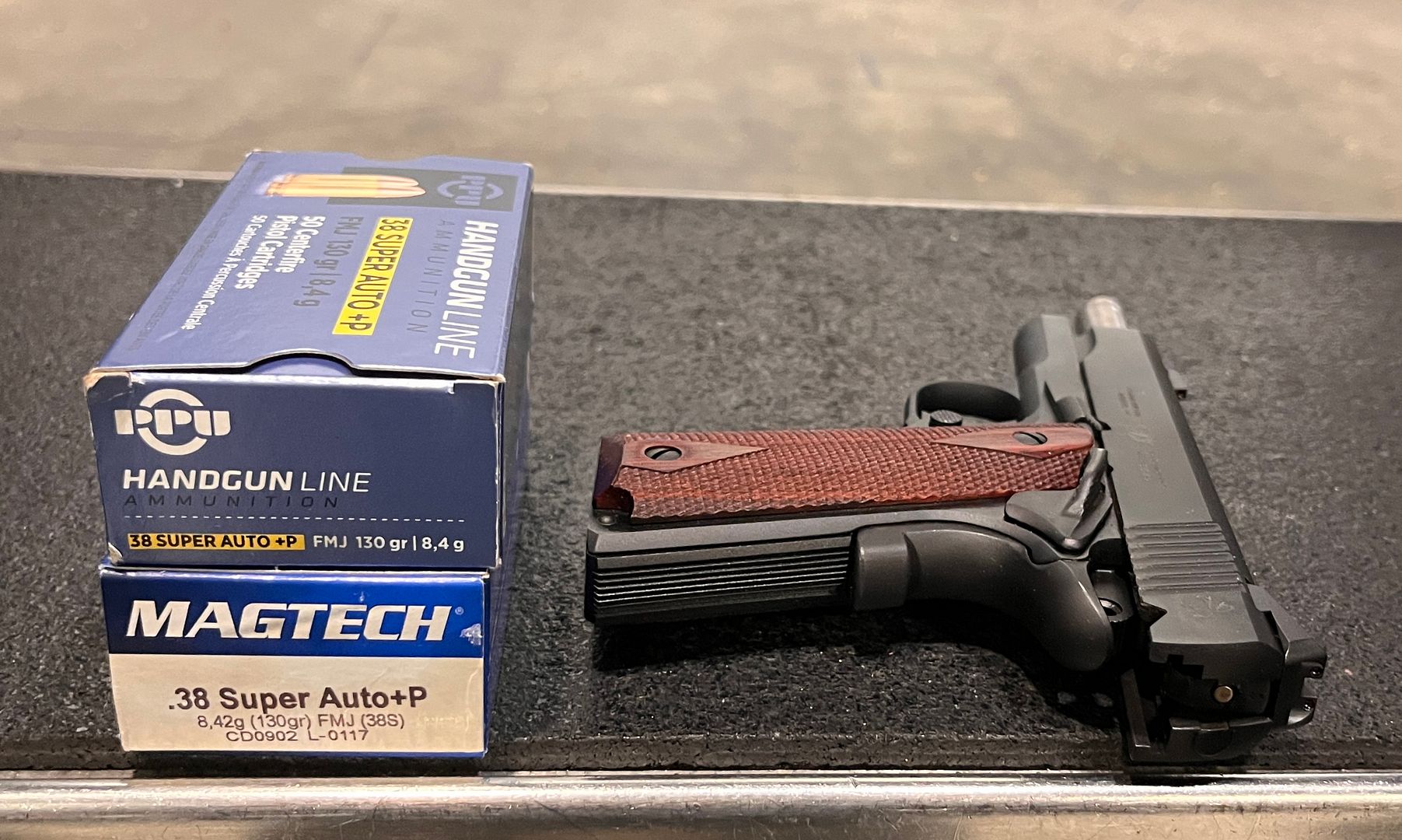

I have a lot of new production Colt Model O. By a lot I mean around high 30s, possibly lower 40s. Out of those numbers, slightly less than half are .38 Supers. The only thing is that this gun is my one and only Combat Commander in .38 Super. I have three Lightweight Commanders in .38 Super, so I at least have some direct comparisons. However as far as Combat Commanders in .38 Super, I only have one. Maybe I should buy me another one, but that’s another topic for a different day.
Anyway, my very first outing with the Combat Commander was with 100-rounds of Armscor FMJ. I had the same problem you had with the PMC, even the malfunction type and frequency were nearly identical. Luckily I also bought one of my well broken in Lightweight Commanders with me and blasted some Armscor through it. Same type of malfunction but with less frequency. So I chalked it up to crappy Armscor ammo. I also had a 20-rounds box of Cor-Bon JHP. Those 20-rounds were fired without a hiccup, and yes, the Cor-Bon was muy picante.
For My second session, I brought out my tried and true Competition as a control piece for just in case there’s any problem. The ammo were Fiocchi and PMC balls. The Fiocchi was a bit hotter than the PMC, and both shot well through the Combat Commander.
For my third session, I brought back out the Competition again as a control piece AND the dreaded Armscor ammo. This time, the Combat Commander ate it all with zero hiccups.
For my fourth and most recent outing, I shot the PPU and MagTech with zero issues.
I couldn’t help but wonder if this Combat Commander needed some breaking in. None of my other .38 Super Goverment Colts needed breaking in. Not even the three .38 Super Lightweight Commanders.

It may be unfair to Colt Custom Shop, but for functional custom work as opposed to aesthetics custom work, I’ll put my faith in Nighthawk.
As far as your Combat Commander’s chamber being out of specs, it could easily happen.
