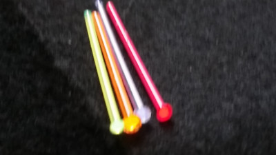

Heya Goldwings, Where did you find it?? I have looked all over their site for sights. Does it come with Green and Red lite pipes? Do you melt the pipe in place like the Novaks?? And have you found where the rear sights are? I know I want a black rear ledge with either a tritium bar or a single T dot or just solid black with a serrated face. I have 2 WC/Vickers tactical rears set up like that with one small rear dot below the U notch but on my gluck 19 slides.
