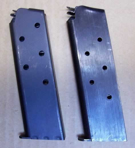

Are these authentic military mags?
Hey guys.
Looking to pick these up from a member.
I am new to this and just want to check with the experts.
Are these true, 80s GI Checkmate mags?
The three opened mags have had the followers updated with genuine Checkmate followers over 10 years ago. The 4th is obviously unopened.
If they're real, would these make reliable, usable, mags?
Also, would you call these "parkerized" or just older blued mags?
I am getting a WW2 Auto Ordnance 1911 and I think these would go well with it if they're the real deal.
Thanks!
Cage number is correct, the rest I don't know about. They look dull blue rather than parked, but it's hard to tell from the pics, at least to these untrained eyes. Some experts can tell by the feed lips, those look GI lips to me, but as I said my eyes are untrained
Those genuine Checkmates. The wrapped example also Checkmate from one of the last major 1911 magazine contracts let by the govt. I notice the third one has a drainhole in the front which indicates made ca. Jan1984 or later.
I carry USGI Checkmates in my range bag for general shooting and never had one fail with ball ammunition. I've never had one fail to feed Silvertip hollowpoints when I've tried it.
I just returned from the Wanamacher show in Tulsa. One gentleman dealing in USGI parts had 7 Checkmates dated 1986 and 1992 still in the wrapper for $25 ea. Other sellers had unwrapped examples in the $20 range. I had those dates so didn't pick up any this time.
The auction sites normally have several up typically in those price ranges. I observed one the other day with a Buy-It-Now for $128.:confused: I have no idea where he came up with that.
1M291 mags are known to be good reliable mags. I would describe the finish on these and many other US mags of that period as 'black oxide', or bluing over a matte finish. You'll notice the base plates have a little shine because they were not blasted. This is also typical of the mags of that period. These mags represent the last contract before the 1911 was obsoleted. There are similar mags on ebay for $17.50 delivered, by manufacturer 8R320. These have the rounded followers like some Metalforms, so I assume that is the mfr. I have two of these and they work fine in every respect.

I'm buying the AO because it is a WW2 clone. I want the closest thing to a real GI magazine to use with it...but reliability is most important to me.
Also, I want a 7 round magazine. No real compromising there.
That being said, if I can get a true GI mag form the 80s/90s that is both authentic and reliable, that is the best of both worlds.
I just bought the 4 that I posted here. The three opened ones have updated, authentic followers, so that is a good combination.
I will also be buying at least 2 of the new Checkmate GI mags. Just wanted to try the real deal first.
He bought them from me. I got them at a gun show new in the wrap more than a decade ago. They have worked fine for me in that time.
I replaced the followers with the newer version from Checkmate as once in a long while one of them would misfeed the last round. Once replaced, no more misfeeds.
He wanted GI magazines and I don't care, so I offered to sell mine for what replacements would cost.

People may not fake them but they sure misrepresent them...I bought a whole bunch on line about 15 years ago, witness holes in wrong places, totally not GI, alas I was a neophyte back then...well, still am, but a more careful neophyte
In general:
Avoid any magazine marked 30745. Those totally non-milspec and most buyers report issues shortly after purchase. Easy to spot due to the witness holes too high, too large and nonspec baseplate welds sometimes showing three weld spots i/o the normal two. Avoid any magazine heat sealed in a paper pouch as those almost always contain 30745 magazines. Some 1950s issue and some repacks have paper pouches but 99.99% contain the fakes. I'm told small sheetmetal assys from the Far East could cost as little as $1/lb and may originate there.
8R611 magazines sometimes have issues. That contractor, Kasco, didn't receive many contracts likely for that reason. I've also observed what I believe a fake 8R611 on another forum. I would avoid purchasing these if reliability is your main driver though some report good luck with them.
1M291 magazines the safest to purchase as I've yet to observe a fake one. A 1M291 caged magazine in heat sealed plastic wrapper with VCI paper dated close to the packing date or loose magazines exactly like what you purchased without any obvious tampering to the feedlips should work for you.
