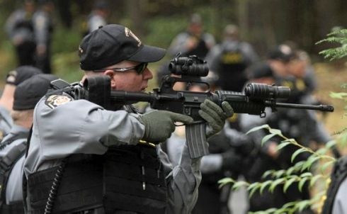

Notice the placement of the Aim Point on these rifles.
Poor location, IMHO, note the lack of good cheek weld Would be better off on a riser in front of the handle/sight set for co-witness.

By the way that gun looks like a GI issue M4. Notice the thin barrel. Possibly another DOD to civilian LE weapon. When the US pulled back from a number of NATO bases a ton of weapons we had stockpiled for the cold war came home and DOD surplused it out to local LE. My M16A1 was new in the wrapper dated 1973.
Has the military ever issued a 16" pencil barrel, fixed carry handle carbine upper? That looks like a civilian upper to me.
