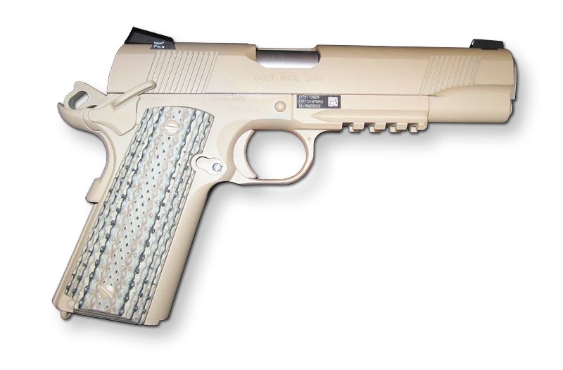

I've been doing a ton of research on the subject of the Colt CQBP and found this prototype photo on Military times' website dated 7-20-2012. I thought it worthy of this thread. Notice the prototype shows the Colt rail gun slide, short trigger, weaver style rail, black stamp UID and smaller grip screws.
There may be other exterior design differences to the CQBP currently in production, but this is all I notice other than the newer frame is much heavier and thicker looking especially forward of the trigger guard. I'll gladly post the link to the article if it is allowed by this forum.
Good info for all that keep talking about the slide cracking issues. You can clearly see the slide & frame differences from the original rail gun.

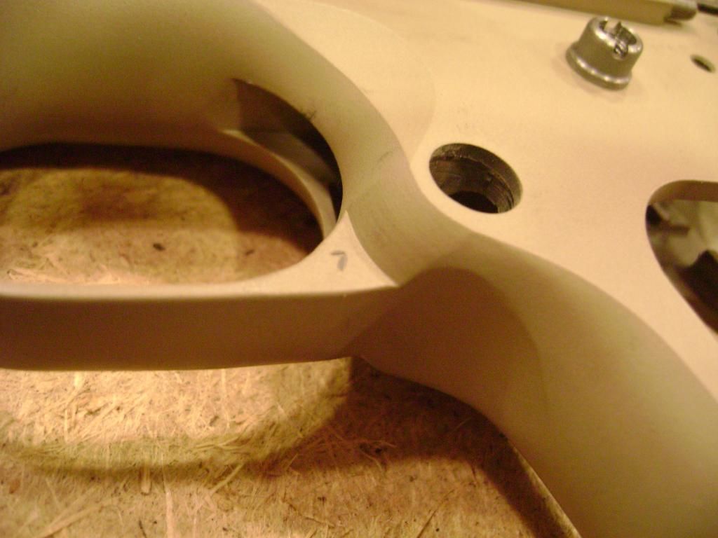

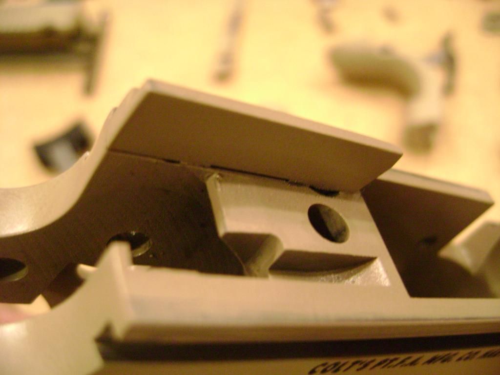

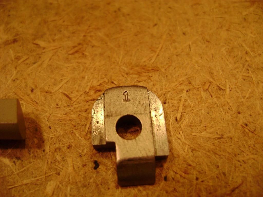

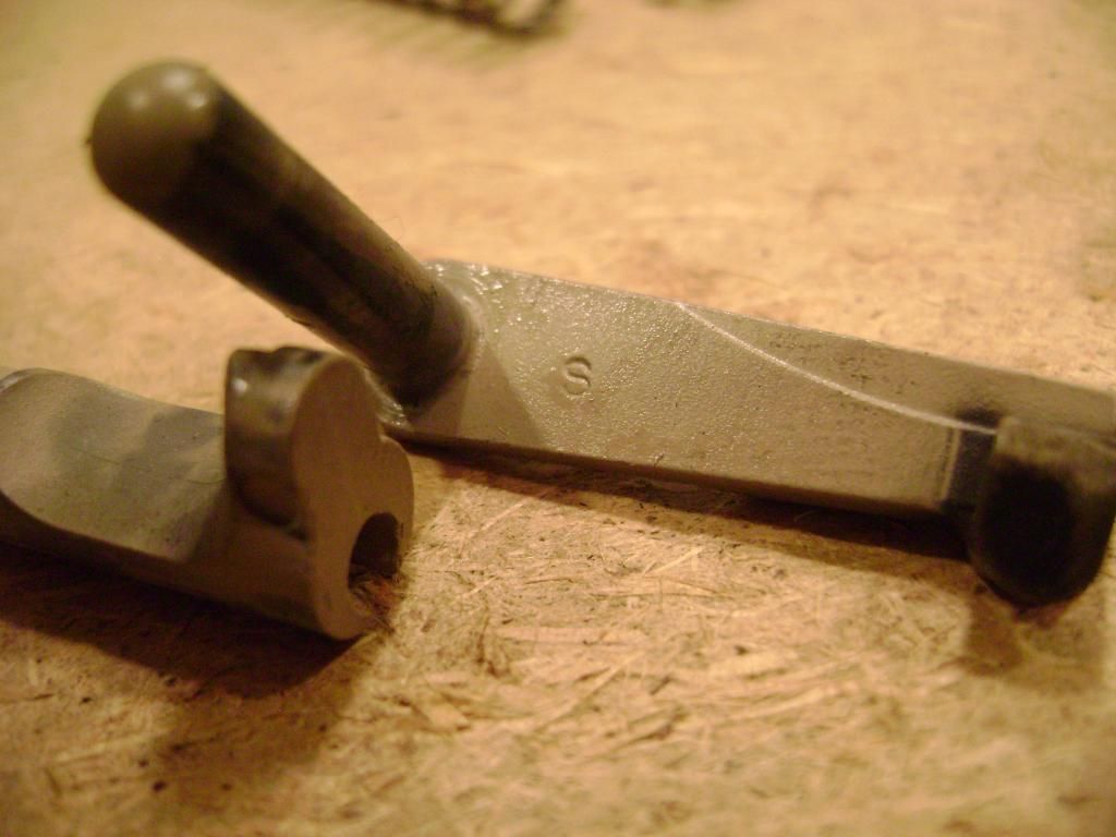

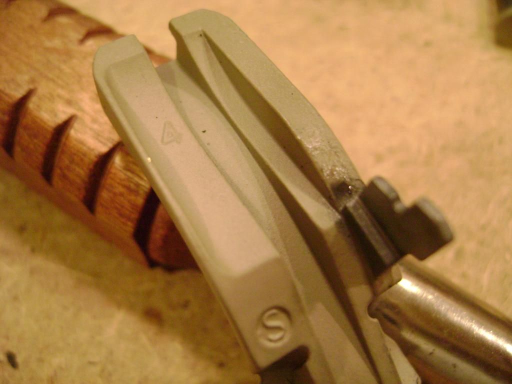

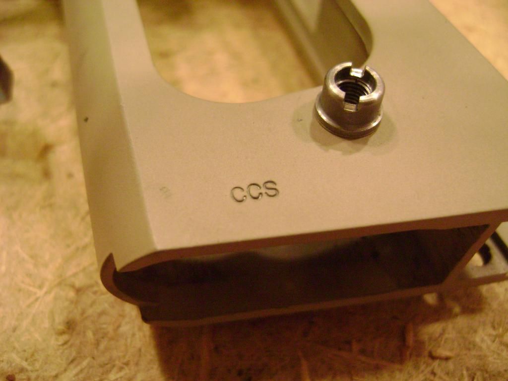

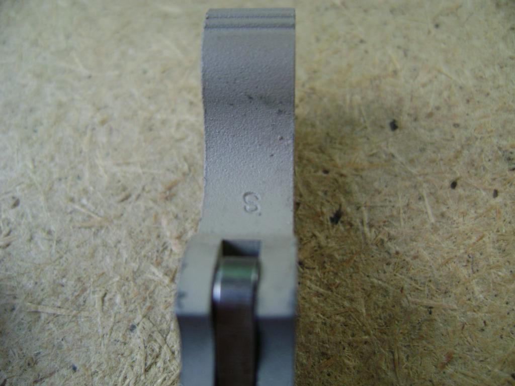

Another fact worthy of being mentioned is that all Custom Shop Marine guns will have the proof stamp on the trigger guard and there will also be a 3,7 or 9 stamped either on the trigger guard or under the grips. There will also be CCS stamped under the grip too. The same applies to all guns built in the Custom Shop.
custom2, thanks for the information on the Colt Custom Shop markings. Good stuff to know.

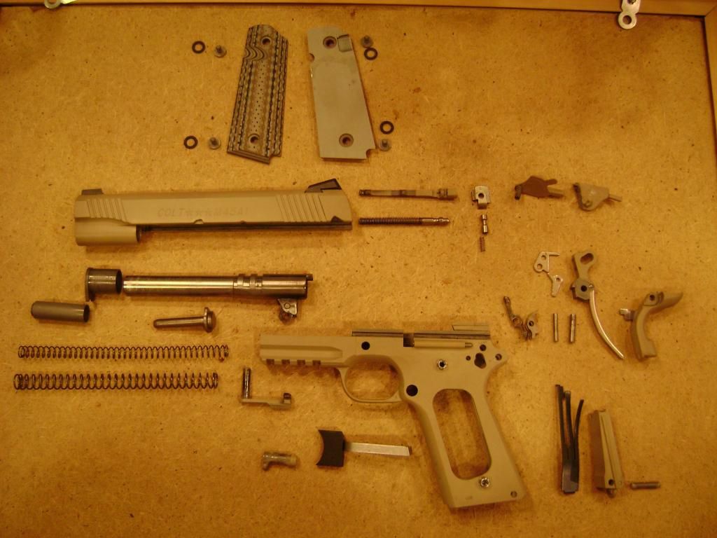

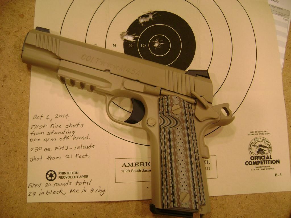

TO YGBSM and all other CQBP fans,
In an attempt to keep this awesome informational thread going, I thought I'd add some pictures of my CQBP that I took when returning home from the range a few weeks ago. This was my first time shooting the pistol after picking it up from the gun shop.
I posted these pictures in my own thread but I believe they belong in this sticky.
Enjoy shooting and learning about your CQBP's everybody!!!
