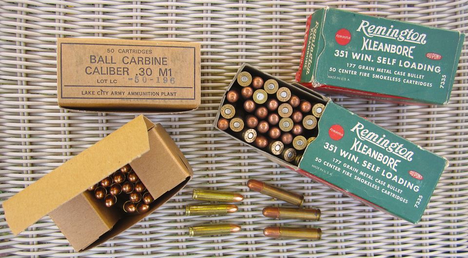

.351 Winchester Self Loading in the older full metal jacket bullet guise, primarily intended for law enforcement and military contract .30 Carbine.

I've always thought that the .351 was the cartridge that the M1 Carbine should have chambered. The .351 S.L. can be thought of as a .30 Carbine cartridge on goat glands. Its .351" diameter 180 grain bullet possesses very nearly the same muzzle velocity as the .30 Carbine round but offers more bullet diameter and weight which translates into significantly more "punch". I'm sure the carbine and its gas tappet system could have been designed around this larger round. The resulting rifle would have of necessity been a little heavier but would have served the War Department's original purpose most admirably.

Since this was written we have the .350 Legend, a cartridge which very much resembles the .351 S. L. in appearance and performance, being somewhat more powerful.
There was the French 8mm Ribeyrolles which was the .351 necked down to 8mm with Lebel's Balle D bullet. The rifle wasn't so hot but a 198 gr spitzer at even 1900 fps would get a lot done from a better action.
Neck to .30 for the USGI 150 gr flat base spitzer and you are pretty close to a .30-30 automatic or StGw or AK. Might have taken us into the assault rifle era without varmint rifle influence.
